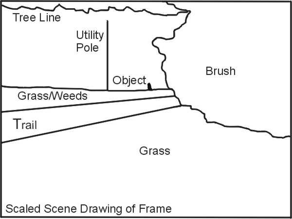

2) Actual site measurements were used to confirm the above data and prepare size and positional information of the trailhead gate, posts, utility pole and other landmarks in the area. The location of the camera as stated by the filmmaker, of 282 feet from the 12-foot bush opposite the parking area, was located and the general view seen on the documentaries confirmed. The original camera position and time of filming stated by the filmmaker is considered accurate, and can be verified by combination of the following: the angle of the trail visible in the documentary, the angle of sunlight shadows of nearby bushes, the apparent size of the utility pole when filmed with the stated camera, the general view of the pond at this location, the view across the pond of a utility pole and tree in some of the video clips – allowing triangulation, and the general view of the roadway landmarks such as posts and poles. The distance from the camera, in the direction of the object in question, to the far side of the roadway will therefore be = 282 feet for further calculations; however, an error of 10 feet here only affects the object size by a few percent or 2 to 3 inches. Incidentally, present day measurements, of the fence posts along the roadway and partially visible in the film, do not all agree with the 1992 positions even when rotated to the proper viewing angles. Either, at least one post has been altered in the last 8 years or what appears as a post is the film is really a result of poor resolution. Other more suitable objects were chosen for size reference due to the questionable accuracy of the post positions in 1992. It is indicated in the documentaries that some alterations have been made to the soil surrounding the posts to keep out ATVs.
3) The exact position of the object in question can be located by agreement of the following deductions. See the illustration of the Cross-Sectional View of the area. Note, the sun altitude is only 23°, the 12-foot bush that the object is stated to be adjacent to will therefore cast a shadow 28.2 feet long across the roadway. Since the object is obviously being illuminated by sunlight (see section 4) below) from at least the waist up, the stated 8 to 10 foot tall Bigfoot cannot possibly be closer than 16 to 20 feet from the bush. When the shadows of taller trees on the hillside are accounted for, their height calculated by reference to the utility pole and the known hill slope, and also viewable onsite, the shadows extend a minimum of 40 feet across the roadway. The observed object’s lighting conditions then place it at a minimum of 30 to 40 feet from the far side of the roadway, which is in the parking area. Of course, the exact shadows are not the same as in 1992, but the general figures obtained from the film make it impossible to place the object at the far side of the roadway. Additionally, the zoomed images clearly reveal that the side of the individual is seen and that it had to turn to look in the direction of the filmmaker. Referring to the illustration of the Top View Drawing, it is easy to see that the individual would reveal a much larger frontal profile if walking at the oblique angle of 54 degrees on the roadway. In contrast, the area near the posts is perpendicular to the filmmaker resulting in the side profile evident in the video. The individual would be about a foot taller if it were located on the far side of the roadway instead of at the posts. The accuracy of the size measurements indicated in section 7) below add even more certainty that the object is located by the posts in the parking area. We will therefore use 225 feet as the distance from the object in question to the camera in further calculations; again noting that a 10-foot error would only result in a 2 to 3 inch size error.

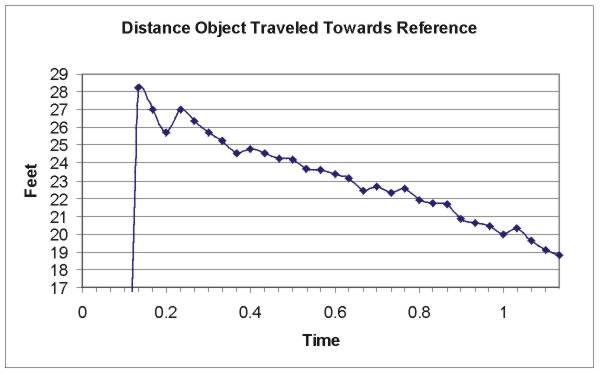

This section will present the analysis results and also compare them to the claims made by the filmmaker. Over a period of almost exactly 1.00 second, the object is seen to move into viewable position from the right side, behind the foreground bushes, and proceed to the left until becoming obscured by roadside brush. After 0.33 seconds, the object reappears at the same location for an additional 0.166 seconds until the camera is rapidly moved away from view. About half of the time the object is visible, the camera motions causes considerable blurring. The object is very small and appears white when viewed on a TV screen; a 27-inch TV will produce an image about 0.55 inches tall.
During the period of travel, the object moves a total distance of 9.4 feet at a distance of 225 feet from the filmmaker. The path of the object is nearly perpendicular from the camera’s view as illustrated in the Top View Drawing and also graphed. The position of the object allows it to catch the direct sunlight accounting for the white color. These positions are in disagreement with Claim 7) of the filmmaker for reasons discussed above in section 3) and 7); the camera was also at a zoom of 12%, not 1:1 as stated in Claim 7). The average velocity is therefore 9.4 feet per second or 6.41 miles per hour. The velocity is also graphed, but appears perturbed, due to the short intervals between frames, camera movement, and motion of the individual’s head. These velocity variations seen in the graph do not affect the accuracy of the average velocity, depicted in the graph by a straight red line. Claim 6) of the filmmaker, concerning the object moving 28 feet in 4 steps at a speed nearly unobtainable by humans is completely incorrect. The actual speed, which is also downhill, is a fast walk or slow jog – about a 9 to 9.5 minute mile in jogger’s terminology. The only guess of how the 28 feet was arrived at, may be related to another error made by the filmmaker in calculating the elapsed time since filming: The filmmaker continually states as in Claim 1) that 17.5 months elapsed, but 16.5 is obviously the correct value. The filmmaker also considers the apparent posts in the film to be 9 to 10 feet apart and the object is said to just cross 3 posts. Is he making the same mental error, 3 posts X 10 feet each = 30 feet, instead of the correct answer of 20 feet in this example? Try this, often confusing issue, on a piece of paper to better understand the point being made. However, the apparent posts visible in the video are not 10 feet apart, but more like 5 feet apart to further confuse the issue. This is why a proper reference object was carefully selected in part 5) of the Analysis Details section.
The size of the individual seen in the documentary, based on the techniques of section 5), 6) and 7) above is in the range of 64 to 73 inches tall, head-to-foot, with all error factors accounted for. A height of 5-foot 9-inch is the mean value and is a very good fit for all the techniques used. Incidentally, 5-foot 9-inch is also representative of much of the adult male population. Claim 5) of the filmmaker, that the object appears 8 to 10 feet tall, is also incorrect. The 69-inch tall object, in the position stated in our results above, will appear 105 inches tall, due to the camera’s up-hill line of sight, when projected across the roadway onto the bush. Of course, the projected image is not a valid measurement. See the Cross-sectional View for illustration of the effect. The 12-foot bush is very difficult to see properly, not a good reference, and therefore not used in this analysis; there is also much doubt of its height in 1992. Claim 5) also states that the waist of the individual is even with the 49-inch post tops, and therefore about twice as tall or 8 feet; Anthropometric data has the waist or elbow region at more like 0.64 not 0.50 of the body height – measure yourself with shoes on for a quick check. The post height claimed as 49 inches is either the wrong post or not referenced to the ground properly, further exaggerating the height of the object. For another quick check, one can look at the film and note that the individual’s head is not any wider than the posts. The posts are 8 to 9 inches across and subject to the same blurring as the individual’s head – the size of a person’s head.
